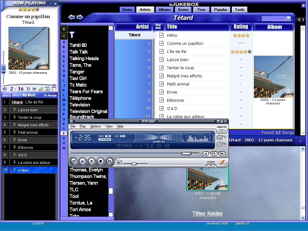

Sure. I think I even have some idea what might be happening: I think it must be in the area of communication between Winamp and eJukebox.
Specifically, my theory is that eJukebox monitors what Winamp is playing, but for songs with foreign characters might not get the response it expects
and loops forever on "Synchronizing"
Why do I think this? Have a look at the screenshot below: When I play a song by "Øye, Erlend", you can see that WINAMP (2.91 version)
displays the artist name correctly in playlist and ID3 Tag view...but not on its own display!!!! There you see it only shows " ye,
Erlend".
So, is it possible that eJukebox waits for Winamp to say "yes, I am now playing Øye, Erlend" but Winamp says forever: "yes, I am now
playing _ye, Erlend" and so eJukebox goes into an endless loop?
The only flaw in my theory: There are some songs with "ä", "ö", "ü" that also cause the lockup, yet Winamp displays them
correctly. But who knows what Winamp reports back to eJukebox on these? By the way, I noticed that Winamp displays the info CONVERTED TO UPPERCASE. Is
it doing that on the programming interface as well? Maybe eJukebox and Winamp have different theories about how an "ä" should be
capitalized?
Anyway, the exact symptoms are always that eJukebox first behaves fine, as soon as a song with foreign characters starts playing (no matter how it was
started, e.g. by playlist, by "play now" or by random play/popularity mode etc.) eJukebox displays "Synchronizing". You can hear
the song playing fine in Winamp, but it never gets displayed in eJukebox. CPU usage goes up, eJukebox sits om "synchronizing" for the entire
song, accepts no input whatsoever, and when the song has finished playing, no new song is queued and basically all that can be done is to kill
eJukebox from Task Manager or reboot the system.
Here the screenshot.

posted on 2-12-2004 at 05:47 PM
I don't think the font used in the version of Winamp you are using contains these characters, and that's the reason they are not displayed.
(And why all characters re in uppercase) It's a custom made font (pixel-drawn, so everyone could draw a new one for their skins) for Winamp in
the old days, and i don't think the graphician ever thought of the "weird" characters.
Have you tried the new Winamp 5? It's a direct descendant of the good old 2.x series, and works smoothly with eJukebox.
posted on 2-12-2004 at 06:19 PM
junk, you are probably right, I didn't think of that. So I was probably way off. But nevertheless the error has to do with
"Synchronization" between eJukebox and Winamp, so there is something going on between the two of them that doesn't work too well.
I haven't tried Winamp 5 yet and I don't think I want to put it on my production machine. It is a slow machine, so I have to be careful what
I put on. One experience with Winamp 3 was bad enough (I know that Winamp 5 is supposed to be better).
The thing is: There is absolutely NOTHING in Winamp 5 that I would want that Winamp 2 didn't already have. As the machine runs exclusively with
the eJukebox interface all day, I could care less about skinning and databases and CD burning etc.
Well, maybe on my normal working PC I may give it a try once just to see if it gets along better with eJukebox...
