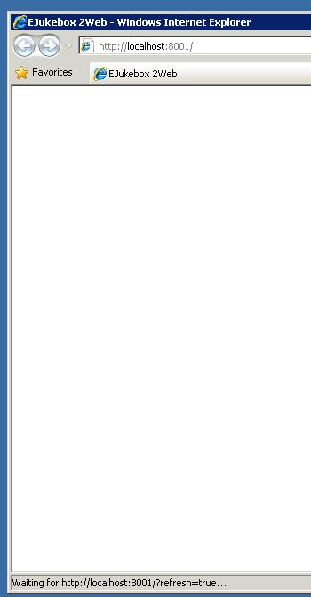

Just re-downloaded the 5.46 from the site and installed and I get the same thing. It almost loads the page . . . you can see the IE header, but the
window contents are blank. See attached screenshot.
Firewall is disabled on all interfaces and added ejukebox.exe to the exception list just for good measure. Also tried the dynamic link forwarder and
it didn't help.

posted on 11-17-2010 at 07:17 PM
is that with the new mediaserver option disabled? if not please try unchecking mediaserver at first and let me know if it loads up then.
also can you try in a different browser...firefox or chrome and see if it works for you?

Yeah, the mediaserver option was disabled . . . tried it both enabled and disabled and all of the browsers do the same thing as IE.
I have some time tonight to dig deeper in to my computer to see if anything else is going on. I am running a usenet application that creates its own
webpage interface on that same computer. I've made sure to shut that down when testing and avoid the port number that it uses, just to be safe.
