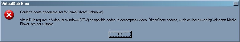

Thanks for the guides Blaze. I still can't get a splitter program to work for me because of the attached error. I can open the .avi files in my
editing programs (such as a demo of Ulead Video Studio, and Broderbund's Movie Shop) though...
Thanks,
Rich
Rich has attached this image:

Ok, we are getting way off topic here, but the easiest way to resolve this would be to get a Video-For-Windows compatible DV codec. Some/most editing
programs will install one for you, but apparently the programs you have do not, or rely on the Microsoft codec, which unfortunately is pure
DirectShow architecture.
Your best choice is the PANASONIC DV-Codec. It's free and its output is 100% pixel-identical with the Microsoft. The only downside is that it is
no longer officially supported, but it works perfectly and just as well or even better than the many commercial codecs that cost $$$.
Look here for a copy (click on
10. DV Codecs)
