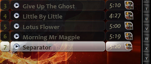

Great! your v5.62 Beta works good Audiosoft.

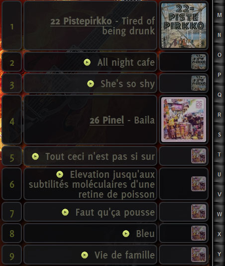

i also tried to mix large and small covers using: [ShowTrackLengthsNotRepeatIcons] Enable=0
looking good too! and it appears that there is room for track length and small covers juxtaposed! i don't know if you'll be hot to allow that? i
think the playlist would look even better, and more functional!
glad you like my playlisttrunc.gif! maybe you could also allow playlisttrunc.PNG?
Many Thanks!

Pirk, actually with the right-align i preferred your 'blank.gif' playlisttrunc
with this exe

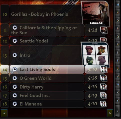

this works to set the font for the track length:
#tracklength {
FONT-FAMILY: Arial;
font-size: 12px;
and so that EJ can show the track length to left of the cover image in the playlist.dis...
[ShowTrackLengthsNotRepeatIcons] has been removed and changed to:
[coverbig]
ShowTrackLength=0
[coversmall]
ShowTrackLength=1
ShowIcon=1
you can even put track length on top of the covers with this example code http://www.audiosoft.net/forums/viewthread.php?tid=762&page=4#pid82436

the mixing of covers and track length now works good. Thank you Audiosoft. i also changed my playlisttrunc!

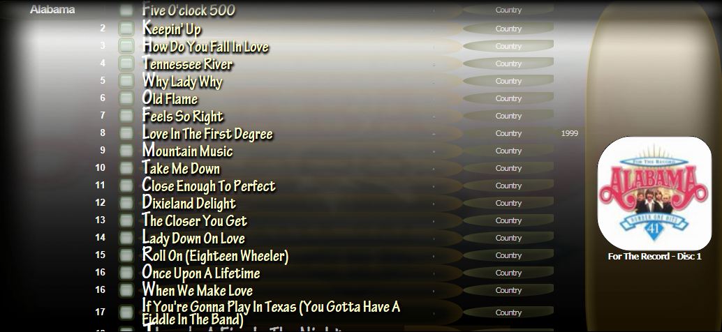

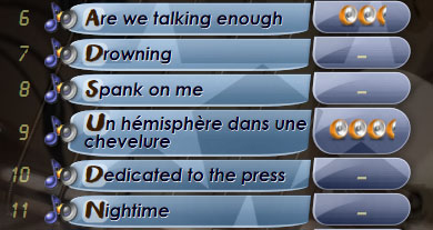

Audiosoft, could you add a way to center the playlist titles Vertically? i mean each title individually in its row, without adding a
"padding-bottom", so the lines are not more height than necessary and more titles are visible. Thanks.

well i've tried your trick, but no success: with vertical-align:middle; no change, titles are still not centered. maybe the image playlisttrunc.gif
interfere?

line-height: do what it is supposed to do, but the titles are still not centered.
i already tried padding-top: 1px; and padding-bottom: 1px; no success.
maybe there is something in the html which shift down texts in the playlist?

posted on 5-24-2011 at 08:50 PM

No, the text is Not centered in all the skins! look in your last screenshot. your titles are not centered regarding the borders:
http://www.audiosoft.net/forums/viewthread.php?action=attachment&tid=2839&pid=82437
| Quote: |
even your screen before last the text was close to the middle. what did you change?
i just reduced padding-bottom to 0px: less height used by each title, but no more centering!

not exactly! the "problem" is there. why texts are not centered naturally in the playlist? i don't have this problem in the songlist.

thanks Pirk you are right again!
try this #title actually controls the playlisttrunc image but it seems to make the text in the middle when you set the trunc to the middle. going to
make this the default in v5.64 so that it fixes all new and old skins so it aligns the playlist titles to the middle
#title {
vertical-align: middle;
padding-top:0px;
padding-bottom:0px;
posted on 5-24-2011 at 09:13 PM
Great! i think you solved my problem! Thanks a lot.

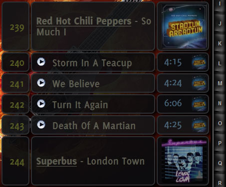

you deserve a glimpse of my new playlist!

Looks AMAZING I can't wait to try it!
i am not proud of yellowjacket. it is kind of ugly
i think now i will try to redo NeoBlues for IE9

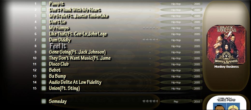

ah good idea Audiosoft! so i tried your palliative in my songlist, and it seems only the first solution (without filter) works for me. the shadow with
the additional filters don't work, at least in my skin: ejukebox freezes (50% cpu). i also noticed even without filter that the additional 1px
padding can produce undesired "carriage returns", or rather the contrary:
EDIT: well it's not the padding. i tried without and the same problem occurs.

hmm thanks for the screens....i see that problem with the text wrapping now. i will try to fix it the best possible when i wake up. for now if you
like you can test if this exe makes any difference on IE9
posted on 5-25-2011 at 12:14 PM
a new exe, thanks! well, good night. (it seems it's worst)

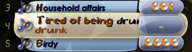

check it out! i dreamed up a fix! :D
with this exe it now automatically wraps the shadow text to match the font/size/zoom in the .title, .titlehi, .titleedithi
in songlist.dis
.titletextshadow { color: hsla(60,100%,0%,0.6); padding-left: 1px; padding-top:1px;
filter: glow(color=#000000,strength=2) progid:DXImageTransform.Microsoft.MotionBlur(strength=2, direction=310)
progid:DXImageTransform.Microsoft.Blur(pixelradius=2);
posted on 5-25-2011 at 10:30 PM
it works good, but for me only without the filters, which is already better than nothing!
maybe you could allow .titletextshadow, .titleHItextshadow and .titleedithitextshadow? so i could use different colors.
with the filters: i can see the shadow effects only once, then ej freezes just after it has shadowed my songlist.
