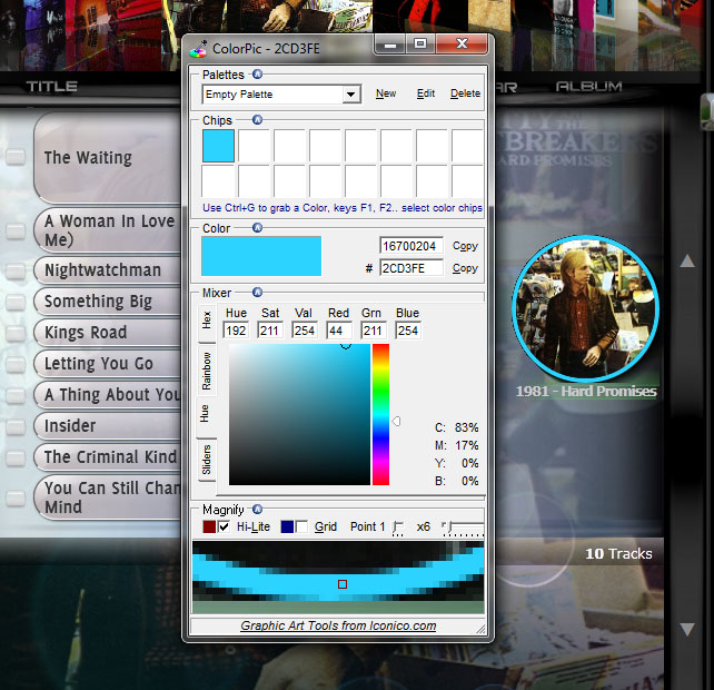

OK I integrated a new Color Picker in eJukebox!
I think "ColorPic" replaces the previous tool advantageously. It has the hue saturation properties, and no bug.. :cool:

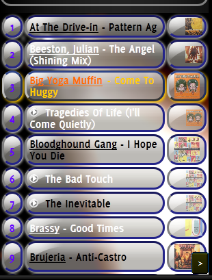

PS: Here is the new playlist i just made for ie9, using the new color picker. all that is very promising!
pl-ie9.png - 119.88kb

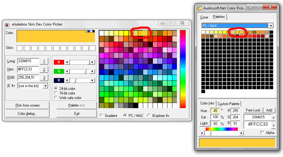

Audiosoft, sorry if i'm deadly: you'll agree or not but i think the new slots are too small to distinguish the different colors in a real palette with very Close Color gradients. maybe you could make the new slots at least so large than before, or more large if possible! (cf ColorPic in my first post/screenshot about that)
and also, still for the same reason, if you could "frame" the selected slot in the Main palettes like before.
PS: the Negative Color small box was also handy in the previous picker.
slots.jpg - 158.27kb
