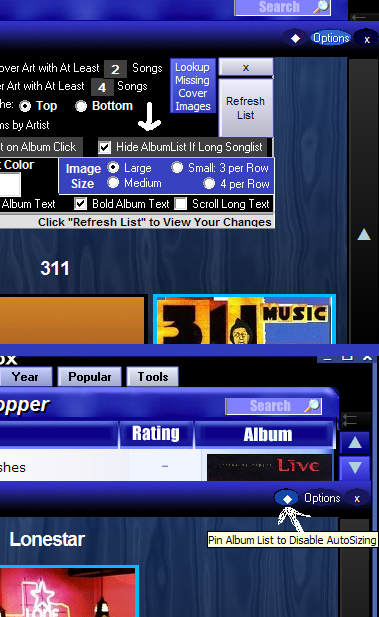

posted on 9-3-2006 at 09:34 PM Edit Post Reply With Quote
Quote:
My only concern now is that when you choose an album from the album list it opens up behind the album list, is this supposed to happen? Is anyone else getting this problem?
VWBUG,
CLICK THE PIN ALBUMLIST BUTTON (SHOWN IN THE 2nd IMAGE BELOW) to fix your problem!!
pin.jpg - 210.27kb

posted on 9-4-2006 at 05:54 AM Edit Post Reply With Quote
oh ok wondered about that.
I dont understand why you would give this as an option.
Thanks again
