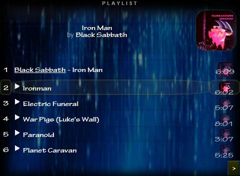

well, a drawing is still better than a long explanation: too much cleaning!
i also noticed the cleaner don't clean the fonts. they are all copied in the zip, even these unused.
ok. in fact i think EJ stops the compression before the work is finished. EJ don't crash, but i get this message: "windows can't add one or several empty repertories in the compressed folder (zipped)"
ouch...
ok found the problem. EJ thought Windows was done with Compression... so the zip never finished being made. because it was waiting for
"Compressing..." window and not yet also "Compression...". thanks your screen was a big help!

here is the one i am playing with for IE9. no images just css so far...it extends a little to the right of the title over the rating and looks a
little like an arrow to the playlist.

i'm doing the same thing: .titlehi overlapping under the rating. i still need to found a good variant for .titleedithi
for .titleedithi, do you like this color?
or would you prefer this version?

ok i already added the new option in my playlist! i don't know if that will work good with your new exe just adding that in my playlist?
That code in the playlist.dis should work good when the user's display option is set to show album icons...which is the default.
ok i'm trying your new exe. well it works but the rows with playlisttrunc.gif are also enlarged even if there is no album icons in them. i would need
a way to differentiate those with album icons than those without. maybe if you can add a specific .NotRepeatIcons {}

i like much the new playlist with large covers:
i noticed the extra-width is only fixed for the First Page of the playlist!
Thanks again for your updates "on the fly"!
i like your new playlisttrunc!
when you get a chance...try this exe and let me know if the extra width is fixed for you
also i have made some changes
this is better because you don't have to worry about the position in the playlist.dis
use .pmnextsongright img {} instead of #upnextcover
use #coverbig { width:37px; } instead of #cover
this exe fixes the width to #coverbig's width: and now centers the #coversmall icons by default for all all skins
Great! your v5.62 Beta works good Audiosoft.
i also tried to mix large and small covers using: [ShowTrackLengthsNotRepeatIcons] Enable=0
looking good too! and it appears that there is room for track length and small covers juxtaposed! i don't know if you'll be hot to allow that? i
think the playlist would look even better, and more functional!

Pirk, actually with the right-align i preferred your 'blank.gif' playlisttrunc
with this exe
this works to set the font for the track length:
#tracklength {
FONT-FAMILY: Arial;
font-size: 12px;
and so that EJ can show the track length to left of the cover image in the playlist.dis...
[ShowTrackLengthsNotRepeatIcons] has been removed and changed to:
[coverbig]
ShowTrackLength=0
[coversmall]
ShowTrackLength=1
ShowIcon=1
you can even put track length on top of the covers with this example code http://www.audiosoft.net/forums/viewthread.php?tid=762&page=4#pid82436
the mixing of covers and track length now works good. Thank you Audiosoft. i also changed my playlisttrunc!
